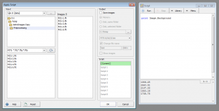

For example, try the following simple script:
Print Image.Background
On a single image, it will print the background of the image.
When used inside the Apply Script Window it will produce the following output:

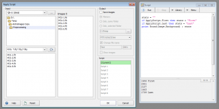

Now add the ApplyScript.First and .Last commands, this is the script and the result:
stats = ""
if ApplyScript.First then stats = "First"
if ApplyScript.Last then stats = "Last"
print Round(Image.Background) ; stats
For example, the .Last could be used to save automatically the content of the output panel.
The .First could be used to initialize some calculations, for example some reference from the first image.
