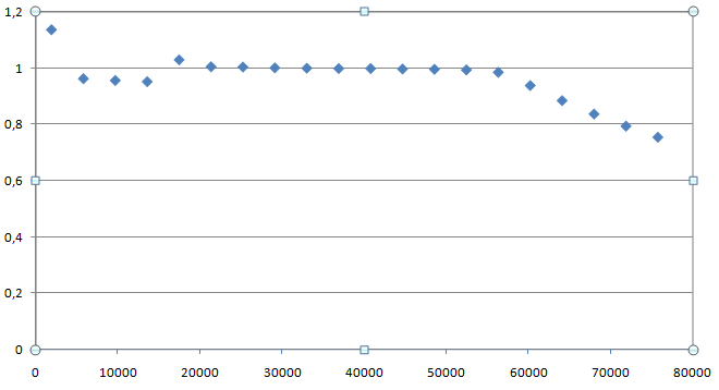

The usual method to verify linearity is to take a sequence of exposures, for example 1, 3, 5, 7, seconds.. up to saturation, and measuring the average intensity of a central subframe, then the linearity can be expressed in percentage with a formula like:
Abs(measured-expected) / expected , where "expected" is a linear interpolation calculated on the data. Sometimes a "1.0" is added to the result, so that the linearity can be graphed as 0.98 .. 1.02, like in the following example:
this was calculated on a cheap camera with the script below, and as you can see, a good flat field can be acquired only between 25000 and 45000 ADU.

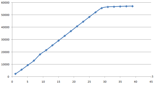

The graph about ADUs versus Time was:
Saturation happens at approx 58000 (not 65500) because the dark frame was corrected, and the antiblooming was active.

the initial exposure is 1.0 seconds, the increment 2.0 seconds, repeated 20 times, so 1, 3, 5, 7, 9, 11, 13, 15, 17, 19, 21, 23, 25, 27, 29, 31, 33, 35, 37, 39 seconds. The actual output of the script was:
Time	Light		Expected	Linearity
1	02209,88	01942,72	1,1375
3	05611,45	05828,16	0,9628
5	09288,68	09713,60	0,9563
7	12946,97	13599,04	0,9521
9	18009,75	17484,48	1,0300
11	21478,18	21369,92	1,0051
13	25363,49	25255,36	1,0043
15	29178,42	29140,81	1,0013
17	33026,25	33026,25	1,0000
19	36872,27	36911,69	0,9989
21	40747,67	40797,13	0,9988
23	44557,65	44682,57	0,9972
25	48385,58	48568,01	0,9962
27	52142,24	52453,45	0,9941
29	55530,34	56338,89	0,9856
31	56503,16	60224,33	0,9382
33	56691,09	64109,77	0,8843
35	56886,83	67995,21	0,8366
37	57026,03	71880,65	0,7933
39	57100,90	75766,09	0,7536
