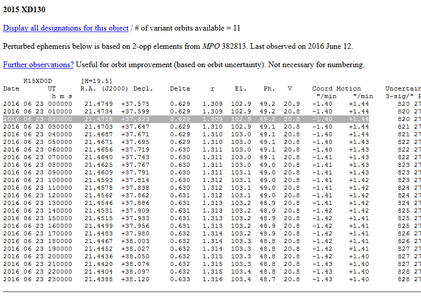

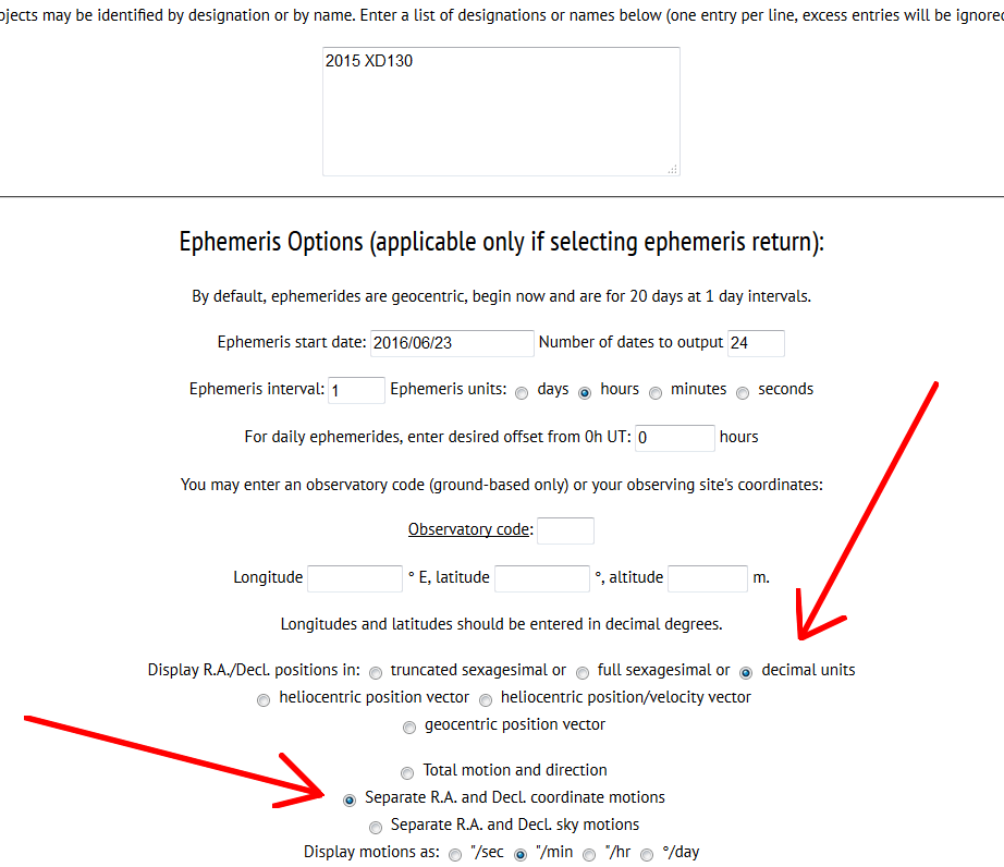

1) Go to an ephemeris service web site, for example the MPC:
http://www.minorplanetcenter.net/iau/MPEph/MPEph.html
2) Fill the data as written in the image below, remember to change the option about "Display RA/Dec" and Coordinate format.
Here we will use the asteroid 2015 XD130 at 2016/6/23 02:00 UT. This should be the approximate date/time when you'll actually take the sequence.
3) Get the ephemeris from the web site:
Select a suitable time (for example 02:00) and copy that date/time to the script:

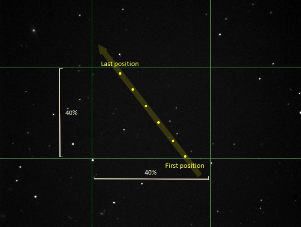

An improved script would calculate automatically when to recenter the telescope, knowing the object speed and the field of view of the camera.
The following script does that, after the user has defined in the code a central region of the image.

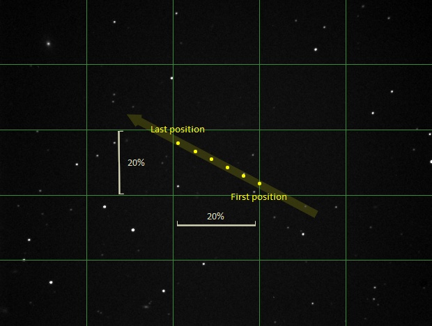

In this example the central region is defined as 40% ("0.4" in the code)
and in this example the region is only 20%:
The telescope is moved so that the object is placed on the "initial" edge of the region, then when the object reaches the other edge, the telescope is moved again. Meanwhile a sequence of images is taken, for a total session time of "TotalTimeMinutes".
