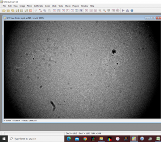

I took some images with SharpCap of the sun in Ca light.
I processed them with AutoStakkert. A PNG file was produced.
When displayed with Microsoft Photo, a nice sharp solar edge can be seen.
When I open it same image in Astro Art, I cannot see the edge of the sun.
I there any explanation for this? Please see both photos.

I think astroart is giving a better rendition of the tonal gradations in the image. MS photo is probably down-sampling to 8bits.
Re: Strange behavior with display
Post by fabdev » 05 Apr 2022, 20:57
Hi, the image is 16 bits (range = 4 .. 53459) so it can be visualized in several ways.
I think that you can emulate the visualization of Microsoft Photo pressing SHIFT + F3, which sets the 0 .. 65535 visualization.
Or press the mouse wheel, then rotate it to adjust the black level in real time. Or use the cursors.

Thank you
This was all very helpful.
