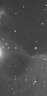

They are present throughout the whole frame.
Thinking that they might be Hot Pixels, I applied the hot pixel filter to each one of the 20 x 5mins subs before dark frame subtraction, aligning and stacking (Sum).
I Suspect that they are hot pixels, which have been elongated during guiding, and thus being shifted in the frame relative to each subs, but neither dark subtraction or the hot pixel filter removes them
This is obviously just a small section of the image, and highly stretched so the problem can be more easily seen, and to this end, I have also blurred the background.
I am using AA8

I cannot see any trace of them in the individual subs, albeit if they are hot pixels, they would be no more than specks in an individual sub.
It is not until they are stacked (SUM) that they become evident, either before, or after dark frame subtraction.
The image shown here is aligned, stacked (SUM), but no debayer or dark frame subtraction.
The image is heavily zoomed to make then more visible.

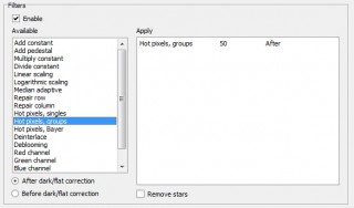

Hi Dave, you may also solve with the Preprocessing Filter:
Hot pixels groups, strength = 50.
See attach, Fabio.

Post by Dave_S » 12 Feb 2022, 16:05
Hi Fabio
Yes, that does indeed also work. :)
Is there any preference for one method over the other, or is either method as good as the other?
Dave
Posts: 466
Re: What are these?
Post by fabdev » 15 Feb 2022, 00:32
Hi Dave, Sigma is usually preferred because it will correct at the same time other defects, like satellite strays. It's slower by the way and it needs several images with random shifts.
Filtering for Hot Pixels can be better if the result image is to be used for astrometry and photometry, unless the image is undersampled (so, with stars of 1-2 pixels).
In this case, Strength = 50 may be too high, try 30 down to 10 to find the minimum value which just corrects the bad pixels.
About Sigma+Sum vs Sigma see also: viewtopic.php?f=2&t=616
