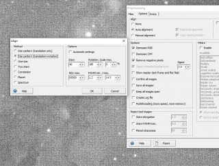

for alignement I use the settings from the first attached image ("automatic" does not work as I get an error message that AstroArt cannot register the 180 degrees rotated images). Sigma is set to 3.0.

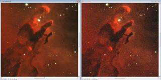

The second image shows a stack of 18 images, of which 9 are taken before meridian flip and 9 after the flip (in a different night). Average is on the left, Sigma on the right. Everything else was left unchanged.
Average is clearly better than Sigma. The camera is an ASI2600MC, but I have had the same problem with other cameras (also mono chips) in AstroArt 7 (not noticed in AstroArt 6).
Actually each of the groups of 9 pictures (before/after flip) sigma stacked has much better S/N than all 18 sigma stacked.

it seems to me that the result of Sigma is just a single image (maybe it's just the first image) and Preprocessing was aborted during Sigma.
Are you using the 64 bit version of Astroart?
Rotation + Sigma of 18 big color images (20+ megapixels) may require up to 10 GBytes of extra disk space, so verify that there's enough disk space for the "Temporary folder" of Preprocessing.
A further test could be selecting "Binning 2x2" in Demosaic: if it works, it's just shortage of resources, which was not notified.
