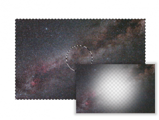

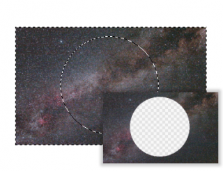

Hello, no but the procedure (for image processing) is the same of photo retouch software.
Masks permit to apply a strong filter on some parts of the image and a weak filters on the others (or no effect at all).
For example last week I was correcting coma on a wide field image: I wanted a full correction on the egdes of the image, no correction in the center, and a transition in between. To do that:
1) Select a circular mask in the middle of the image.
2) Invert the mask.
3) Smooth the mask.
Now the Compress Stars filter will do the job, compressing more in the edges:

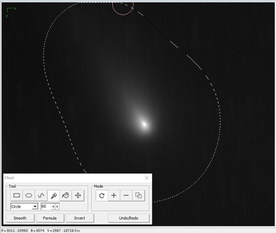

3. with the mask-function i draw with the paint-tool (about 60 pix in diameter) the comet with tail as the mask and then i used 'smooth' of the mask tool window

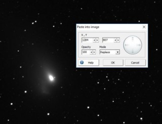

4. now i 'copy' the mask of the comet and 'paste' this as 'into image' and position on the image which was stacked on the stars.

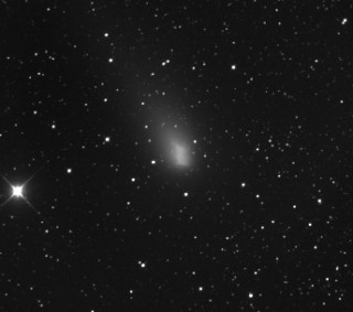

5. finally result can you find here.
