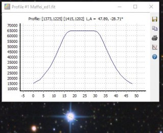

Forum_2018
Posts: 263
Joined: 17 Dec 2018, 14:45

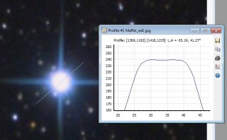

Re: Cannot platesolve processed image
Post by Forum_2018 »
In this image the problem is not platesolve, it's the stars.
If you place the mouse over them you'll see that they are not recognized, because the 8 bit JPEG saturated too much (10 pixels of saturation, there are also small "valleys" in the middle). The Astroart star recognizer is maybe too strict about it. In any case a good precision of the centroid is lost.
About some 16 bit files that where not platesolved, verify again the stars, you may increase the FWHM max in the Preferences. If the stars are really extremely saturated you may try a light Gauss filter, then platesolve, the Undo the filter.
Just as a test, that JPEG image can be platesolved reducing the size of saturation (size of the image), for example with the command Binning2x2. Then the image is correctly platesolved (but the N-E marker is not shown immediately, this is a bug on color images, to solve just Copy and Repaste the platesolved image, or just Save and Reopen it).
Forum_2018
Posts: 263

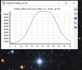

Hi Fabio,
Thanks for the explanation.
I tried light gauss blurr, several attempts ranging from 0.1 up to 5 in smalle steps, but with no success.
I am using the full fits file:
http://b-rasmussen.dk/astro/2018/1210/Maffei_ed1.fit
The dip is not present in the fit file image, it must be a JPEG artifact.
