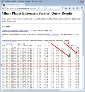

Hello, it's the angle given by the MPC.
http://www.minorplanetcenter.net/iau/MPEph/MPEph.html
In the mask below select a hourly query (1) , if the object is a NEO you may need to select your earth location (2)
Click "Get Ephemeris", then in the query result select a UT near your exposure (22:00 in the example). The angle is the item (2) which is 241.4, the speed is the item (1).
