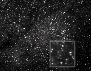

Also, drizzle is useful only if the image is undersampled, here is an example:
Undersampled images are the result of short focal instruments with low-res cameras, stars are usually 1-2 pixels wide.
