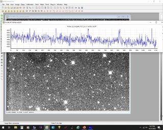

When I either add or average images in AA6 SP4 I get a noticeable vertical variation in the background.
Why is this happening?
Thanks

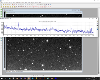

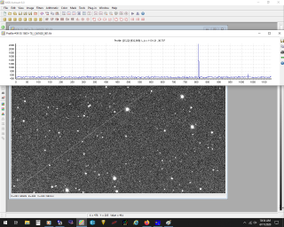

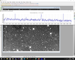

I am attaching images added and stacked without BDF
Thanks all

the problem is visible also on the single image, it's only masked by noise.
For example, in the last image of the first post, if you remove stars with the command "Ring Median" radius = 60 then the problem is visible.
You can verify if it's amplifier glow or charge accumulation if the problem is visible in dark frames. You could use Median or Gauss filtering to detect.
