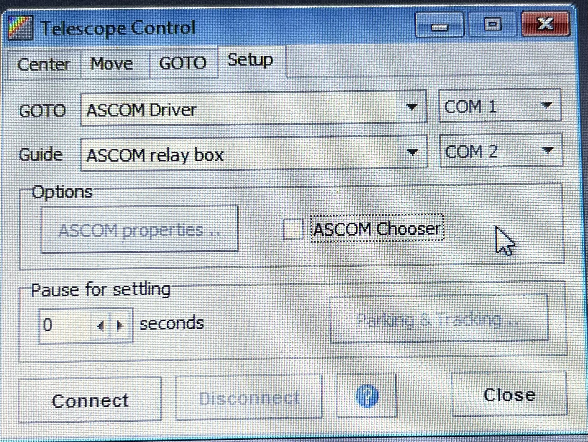

I was able to do some testing last night but ran into problems. I picked up an Ipolar and wanted to see how it performed using Sequence Generator and PhD2 as this is what I’ve used for several years. Needless to say the Ipolar did a very good job.
When I switched to AA8 all seemed to go well, connected the QSI683wsg, QHYLii, filter wheel but it went south once I connected the “telescope”, or mount. In the setup above I connect the QYYLii output to the autoguider port on my Losmandy G11 which has worked well, but doing the same with AA8 caused a lot of screen freezing, a number of not responding messages and had to reboot AA8 and disconnect/reconnect everything to get it going again.
I suspect a few things:
There wasn’t a “on camera” selection To connect the “Telescope”, or mount, so I used I used the ASCOM Driver / ASCOM Relay Box selections below. I was able to calibrate and start guidIng but this is when the freezing and AA8 not responding started. Maybe these are not the correct choices for my setup.
I don’t usually control the mount from the computer for GOTOs and such, I use the hand controller, but can if this is the best choice. Id prefer to keep cables to a minimum and not adding another cable if possible.
Also, I use an unpowered USB hub and have 3 connections, the main camera, guider, and focuser, so maybe a powered hub would help.
Also, I’m using and i5 computer running Windows 7.
Any help is greatly appreciated.

If you will be imaging and guiding with Astroart and you connected to your mount through its ASCOM driver select "camera 2 relays" for guide if you have the guide cable connected to your guide camera. If your guide cable is connected to your imaging camera select "camera 1 relays" for guide. If your mount supports pulse guide you can skip the guide cable and select "same connection of goto"
Hope this helps.
Re: Full Frame Focus Exposure Time By Filter
Post by fabdev » 26 Mar 2023, 11:58
ASCOM relay boxes are rare hardware which converts USB/serial to an autoguide cable, it's probably not the correct settings.
If there is no need to control the mount for GOTOs, I confirm that the correct setting is:
"Camera 2 relays" / "Same connection of GOTO"
or
"ASCOM guider relays" / "Same connection of GOTO"
in both cases they are the Second / First items in the lists.
