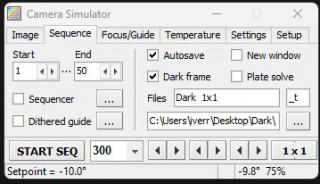

Good Morning,
can somebody help me to automate my darks library.
for example how can I automate 50 darks with temperature -10°c and 300 seconds?
where can I see the actual temperature of the sensor.
best regards
Rob

Here is a screen shot of a dark sequence bin 1x1, just change the name and bin mode to Dark 2x2 and run it a second time.
The camera Temperature and power % is shown in the bottom right corner of the camera control window.

thank you very much iver that was exactly what I was looking for
