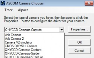

Hi, usually that is managed by the manufacturer with something like "Camera 1" and "Camera 2" in the ASCOM Chooser. Here is a quick example from Atik and QHY cameras:
I suggest to ask the manufacturer what is the procedure to control two cameras with ASCOM.
