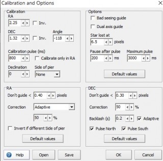

I guide with AstroArt, but have a problem with dither.
Every image that was dithered is capturing while moving the mount.
Here is an example. Maximum shift on x and y is 2 pixels.

Are you imaging with an SCT, could it be mirror shift?

Yes, I am using a Celestron 11, but It can't be mirror shift.
I am dithering every 3-rd image , and every 3rd image shows this "double" star.
It looks like dithering is going on while taking images.

During the dithering, the cross in the autoguide window becomes blue, so it's possible to verify visually when dithering starts and ends.
It's strange that "double stars" are almost equal, it looks like a 25 seconds / 35 seconds exposure.
Maybe the bigger pulses sent during dithering caused something in the mirror or in the mount? You could solve setting Spiral Dithering, which moves the reference by only one pixel at a time. Or just use 1x1 dithering which will give 5x5 different positions on the image (dithering 2x2 moved the image by 10 pixels).

Are you guiding through a Guide scope? It could be mirror shift and or differential flexure. If you are using a guide scope try not dithering.
