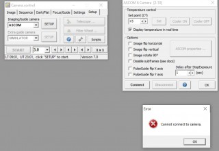

Hello, about problem #2, please post a screenshot with the camera options and the error "Camera not found".

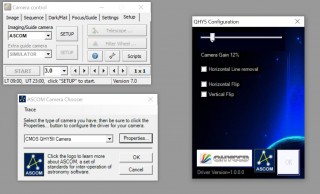

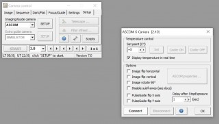

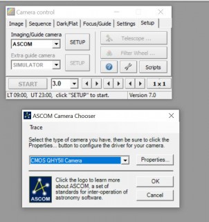

re the QHY5L2 the error was "cannot connect to camera" not "camera not found". Apologies for the error - I had been playing around with things for hours and wrote the email quite a while after I had stopped.
Attached are screenshots of each connection stage using camera plugin with the QHY5L2. It is connected as main camera, but the behaviour is identical when selected as a guide camera. Also attached is a screenshot of the guider attached to PHD2 with no issues.

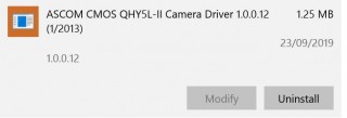

Testing shows that it will connect using the latest driver ,QHY5IIDriver160519(Beta), but when using a very old ASCOM driver see attached snip
Will not connect using latest ASCOM driver.

Hello, I'm glad that you solved. Some notes:
It seems to me that PHD was connected to the camera via a native driver, not via ASCOM(?), maybe via ASCOM you would have obtained the same result?
The ASCOM QHY was indeed very old (1.0.0) and it showed the name of another model (QHY5II) which is different from the QHY5IIL see:
viewtopic.php?f=3&t=89
