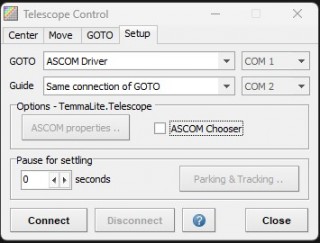

Hello All.
Well I'm out setting up for some image testing tonight and wanted to know what would be the settings if I wanted to control my G11 for GOTOs? Will the above setting are recommended for not controlling the mount, but will these work or should I use another combination?
Thanks.
Joe
Posts: 116
Re: Full Frame Focus Exposure Time By Filter
Post by Iver » 22 Apr 2023, 03:39
To control your mount select ASCOM driver. For guiding select same connection as goto for pulse guide or if you are using a guide cable from your camera to your mount select camera 2 for your guide camera or camera 1 if your using the relays from your imaging camera.

Post by Joe R » 22 Apr 2023, 05:45
Iver,
Thanks. I did use those settings which worked just fine. I did run into a number of problems though, not related to the GOTO connection.
Initially I couldn’t get a good image from the guide camera, all I got was a black image with no data. I disconnected/reconnected the guide camera a few time, but nothing. After restarting AA8 a couple times I finally got an image.
Next, I couldn’t get the the guiding going with the guide camera connected directly to the mount. The guiding appeared to be working but in actually no corrections were getting sent got the mount. I tried the suggested settings on the thread, but gave up and connected the mount directly to the computer, which worked well.
