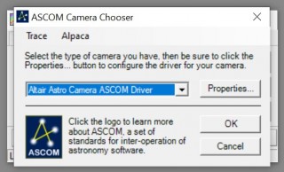

On the Laptop, the 'Camera Chooser' window in AA8, only shows 'Trace' as an option, whereas on the Mini PC running Windows 8.1 Pro, there are two options, 'Trace' and 'Alpaca' (see attached screen shot).
Although Alpaca is not enabled, it still won't connect to the camera. As I said earlier, Alpaca enabled or not enabled, makes no difference.
