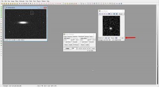

I've attached an image with a red arrow pointing to the triangle. There is a detailed help page on focusing and focusers. Click on the camera control settings tab and then click on the blue question mark to get the help menu.
