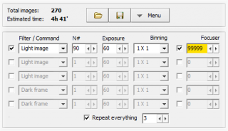

Hi, there are some arduino projects, but then you will need to use scripts to program the behaviour, reading the temperature via the virtual serial port.
If you need to take a long sequence and just need to autofocus every 90 minutes, you could build a sequence like: autofocus will be launched at frame 1, 91 and 181.
Assuming that autofocus takes less than 2 minutes, you will lose less than 2% of the session time.
