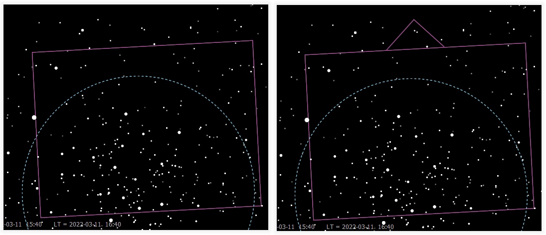

* Improved. The camera frame in the atlas shows the field size in arcminutes.
* Improved. The image frame in the atlas can show the orientation.

Press "D" in the Atlas to display the UP direction of an image frame, example: Press "R" to rotate the Atlas so that it's aligned with the image.
